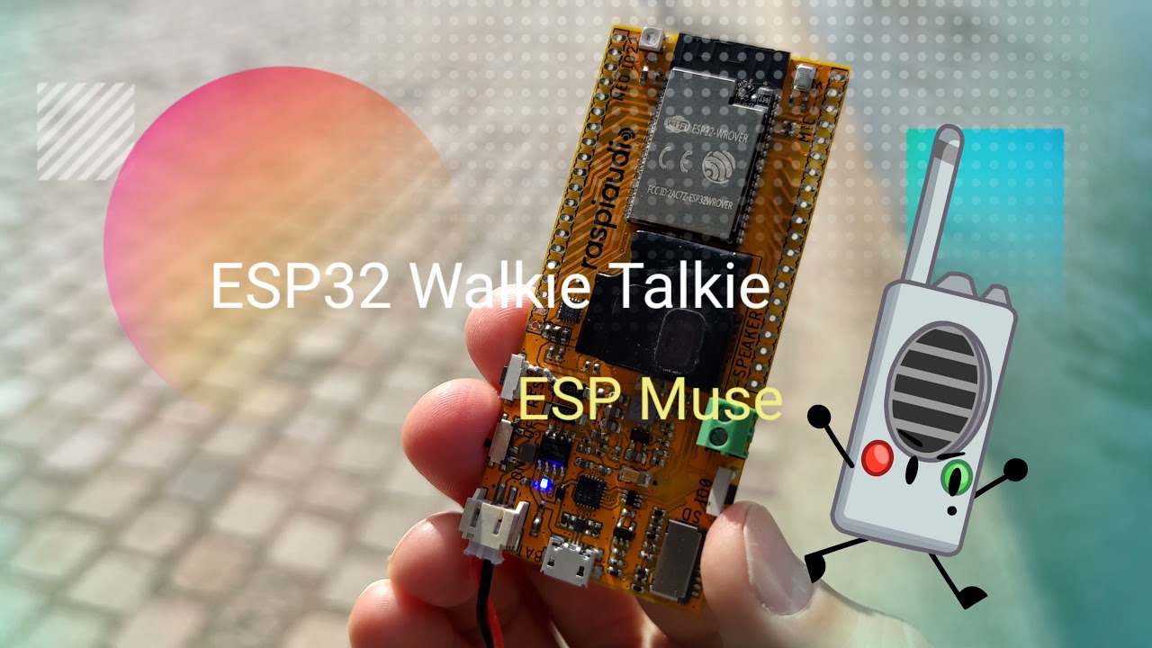

Hi Niels,
So what would be the adavantage of such a device compared to the existing Muse Proto? because I think you could do RS-485, SPI, I2C, UART with the Proto already.
And the ESP32 PICO I think does not have a lot of PSRAM that is needed for Squeezelite.
Do you have an intercom project example to recommand?
