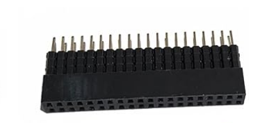

Problem found & solved…
Due to space in my pi 5b chassis, I had to use double pin header (2x20). Using only one pin header, and my dab radio is working again.
Can anybody recomend a raspberry pi 5b chassis for my dab radio ?

search for “raspberry pi riser” on amazon or aliexpress to get something like that, i’m using the RPI 5 official case.

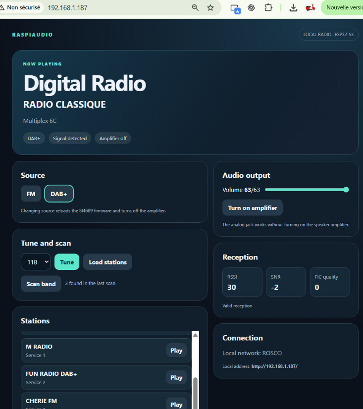

News!
The digital Radio hat for Raspberry pi is now supported by our ESP32 Zero Core. In a nutshell you can substitute a very expensive or rare Raspberry Pi by this ESP32 board.
Full doc here:
there is also the pinout if you wish to connect a thrid party ESP32 board.
we also made a lite web interface for it running on the ESP32:
I have a Raspberry Pi 4 with the official 7” touchscreen. It takes power from pins 2 & 4 of the GPIO. Does the GPIO riser allow access to these pins?
