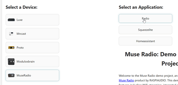

Could you try with the basic “Radio” apps available here apps.raspiaudio.com and check if you have the same issue?
