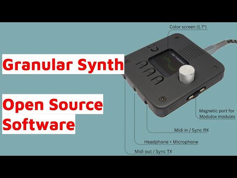

๐ŸŽ›๏ธ Modu-Grain: The Granular Synth for MODULOX BRAIN! ๐ŸŽ›๏ธ
:control_knobs: Modu-Grain: The Granular Synth for MODULOX BRAIN! :control_knobs:
Modu-Grain, a powerful granular synthesizer developed specifically for the MODULOX BRAIN. Built for musicians and sound designers, Modu-Grain opens up a world of granular sound exploration and creativity. :musical_notes:
:link: Get Yours:
Learn more and purchase the MODULOX BRAIN here.
:high_voltage: Why Choose Modu-Grain?
Modu-Grain is not just another synthesizer; itโ€™s a creative platform designed to inspire and empower:
  • Pre-recorded Samples: A library of built-in samples to kickstart your production.
  • Four-Voice Polyphony: Create complex, layered sounds for richer audio experiences.
  • Advanced Sound Control:
    • Adjust grain size for texture variation.
    • Fine-tune density and envelope for precise sound shaping.
    • Introduce random playback for dynamic performances.
    • Control sample duration to fit your creative needs.
  • Real-Time Interaction:
    • Visualize and adjust waveforms live.
    • Record samples on the go using the built-in mic or external input.
  • Dynamic Effects: Customize your sound with real-time effects like Filter, Delay, and an assignable LFO.
  • Seamless MIDI Integration: Enhances compatibility with diverse audio setups.
  • Precompiled Firmware: Ready to download from our apps store
