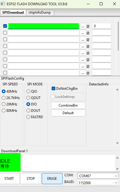

It seems that ESP32 FLASH DOWNLOAD TOOL can also do an erase.

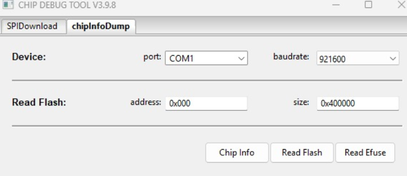

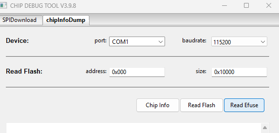

It also has a Read Efuse feature:

maybe you can read the EFUSE to understand what is happenning using
https://docs.espressif.com/projects/esp-test-tools/en/latest/esp32/production_stage/tools/flash_download_tool.html
then there is a command to write the efuse but it is risky
