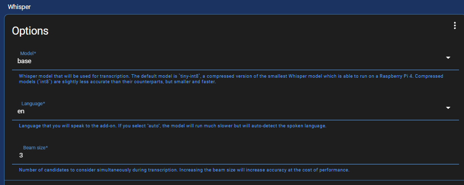

Increase the beam size. Resource consumption will be affected, but so will the accuracy.
Thanks, I increased Whisper beam size from 1 to 3.

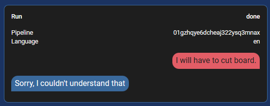

“unlock front door”:
That is painfully hilarious, unfortunately :sweat_smile:
Even with beam size: 5 it can’t understand me. I’ve tried both model: small and medium: int-8…

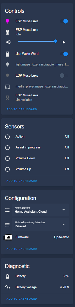

And after that last step, I can see Muse Luxe in my HA but it never shows available as Media Player. I really think this is broken.
This is what I get:

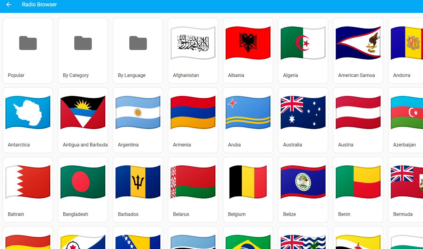

Of course I select something to play. I never thought I needed to say that. Doesn’t play if I choose a Radio Station, for example, or any media file I have. It just doesn’t work.
