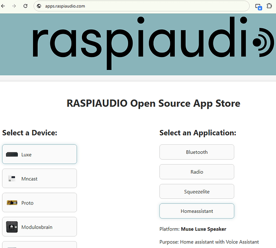

Hello, good news. We have a much more stable Home Assistant build for the Muse Luxe.
Features
  • Improved wake-word accuracy
  • Wake word selectable from the main panel
  • Reduced LED and audio update frequency to save resources
  • Switched to a WAV audio pipeline to save resources
  • Fixed loud crash issue
  • Audio jack output (Luxe V2 only)
Because this is a major update, you need to reflash your Luxe from our Open Source Apps Store.
Future updates will then appear via the Home Assistant Updater.

You can now use pre-cooked firmware for the Luxe for Voice Assistant with Wake word (select Luxe-Home Assistant)
