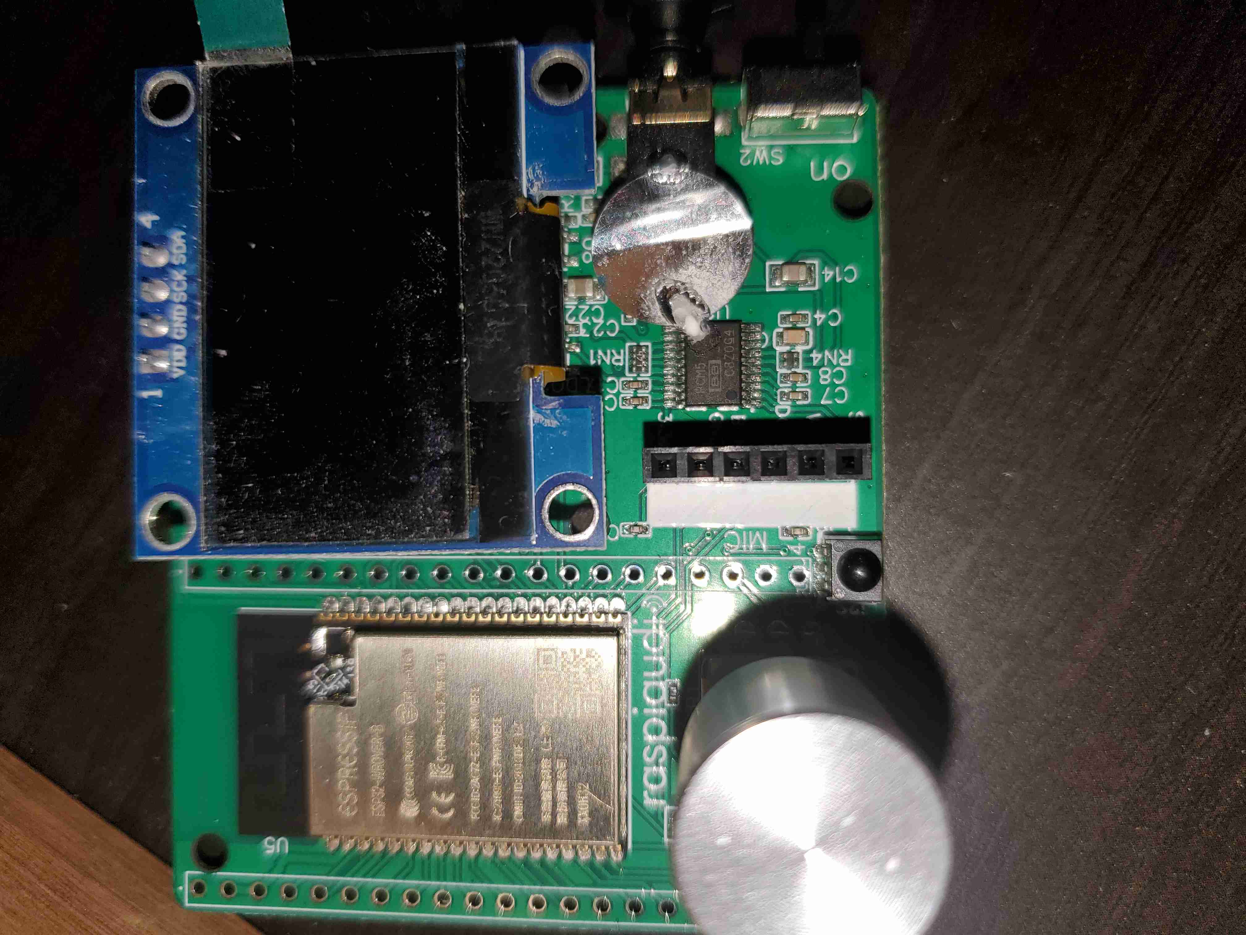

By the time your suggestion came in about the plastic tape came in, I had managed a fix: I had a piece of reflective, rigid confetti that I was able to position usefully, and then glue into place.
Here’s a picture of what worked for me:
this is quite creative well done!
