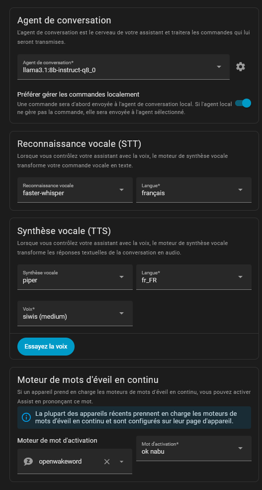

I dont change my conf (ha and assist) befor or after upgrade and a don’t upgrade HA or module of HA
My conf:
TY

Try anyway - just for a test - to make changes to the different sections of Assist. Try for example:
Conversation agent => Home Assistant
Speech-to-text => Home Assistant Cloud
Text-to-speech => Home Assistant Cloud
Keep me posted on your progress…
