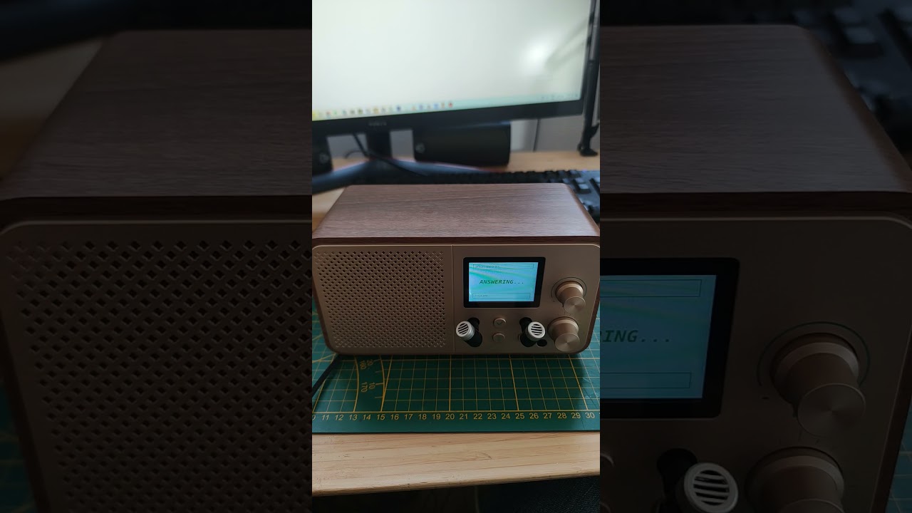

To answer your questions:
- I noticed that sometimes the encoder slightly touches the case, but after turning it several times, the issue tends to resolve itself as the plastic gets slightly polished using it.
- Indeed, the screen frame reduces the visible area by 1.5mm on each side. I’m not sure if there is a way to crop this in Squeezelite.
- The IR codes for the included remote are available in the repository and should be added to your LMS files to make it functional. The process is described in the Squeezelite repository. I hadn’t realized before that the original Logitech remote could work, but it makes sense since it also uses the NEC protocol, just like ours.
