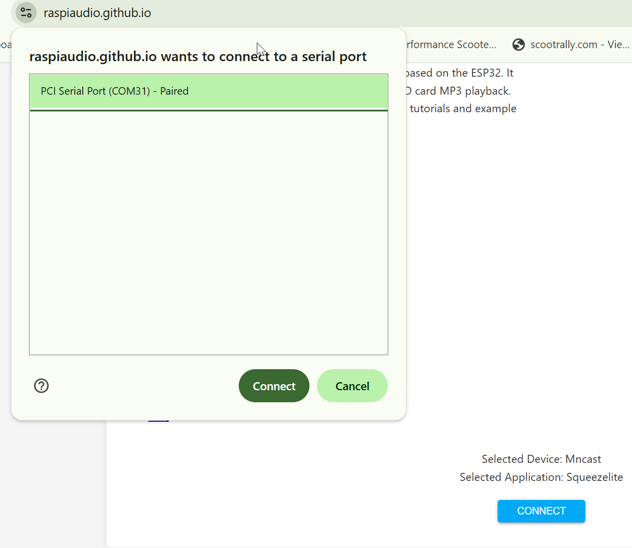

I plugged in the usb-c to my computer, and also an optical cable from the audio port to my AV-Receiver. When I turn on the switch, it says “Mn Cast Test” or something, seems to want to go through the test. At the end of step 4, which it says “Test #4: sound ok”. And then it stuck. All LEDs are off, I try to flash the firmware, but Edge browser can’t detect it.
Restart by unplug the usb-c or turn off and on the switch will restart the testing process.
What should I do now? How do I starts the “Squeezelite” which is suppose to be flashed?
Flash the software you need here :
I solved it, I installed the driver that online tool showed me, and then I can flash it according to the guide.

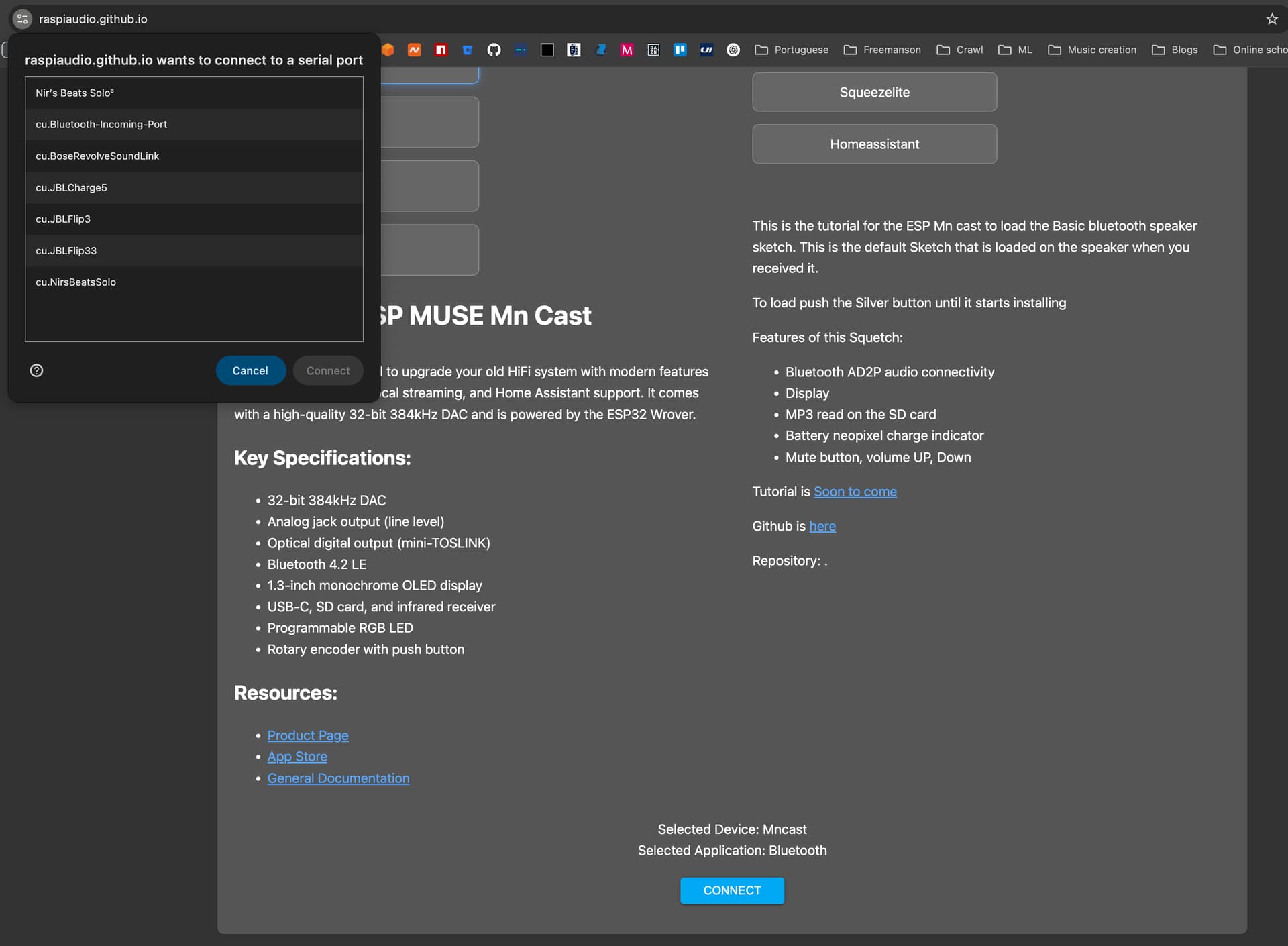

Same problem here. But the flash software manual not much help as I can seem to find it when I plug it into my macbook pro 16 inch 2021 using apple usb-c cable. The screen is not showing anything in the display (when connecting it to a charger I see the tests app which stuck on test #4 with: “OK”).
What can I do here in order to make it work with my mac and flash it?

That is my problem, I can find it on the serial port connection pop up. Also not when trying the Squeezelite-ESP32 Installer

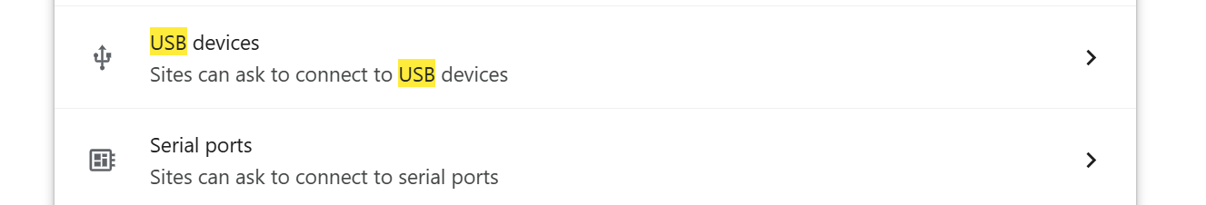

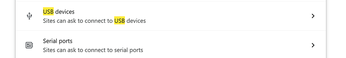

I think it’s more an authorization thing try both:
  • Browser-side: You can change or pre-approve that under Settings → Privacy & security → Site settings → Additional permissions → Serial ports / USB devices / HID devices. support.google.com

It uses a CP2104 chipset for the serial USB but this does not need a driver usually on Mac. This does not show as it is tested by me before shipping the chance that it died in shipping in close to 0.
You picture only shows Bluetooth devices so was thinking that authorisation on serial.

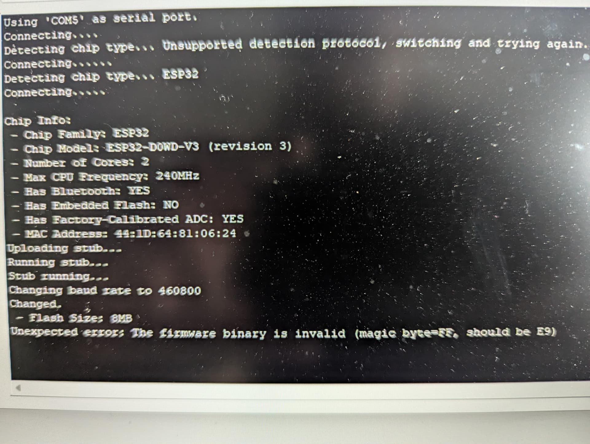

Now tried my esp flasher locally, feedback it gives me when trying to flash the bin file on your repo:
Unexpected error: The firmware binary is invalid (magic byte=FF, should be E9)
