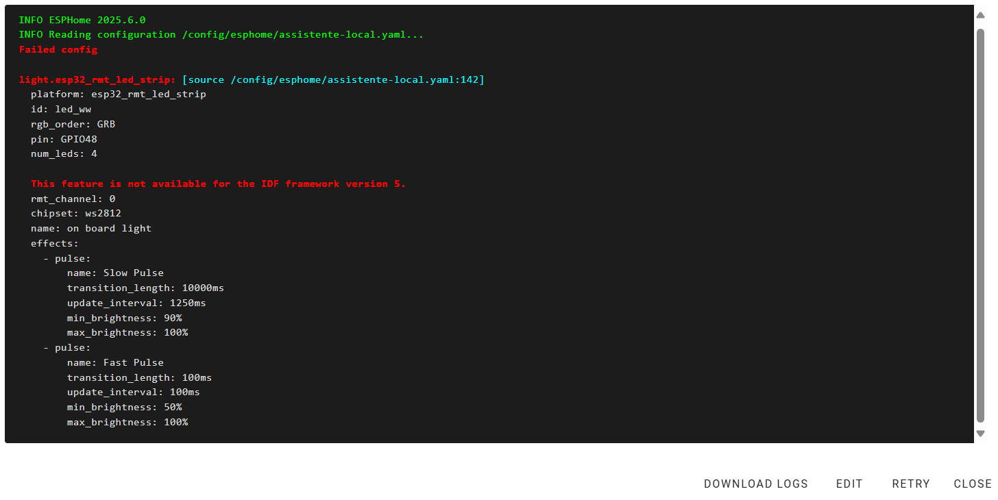

Iâm facing this error when I try to update over the ESP GUI in Home Assistant
Is there any way to solve this?
