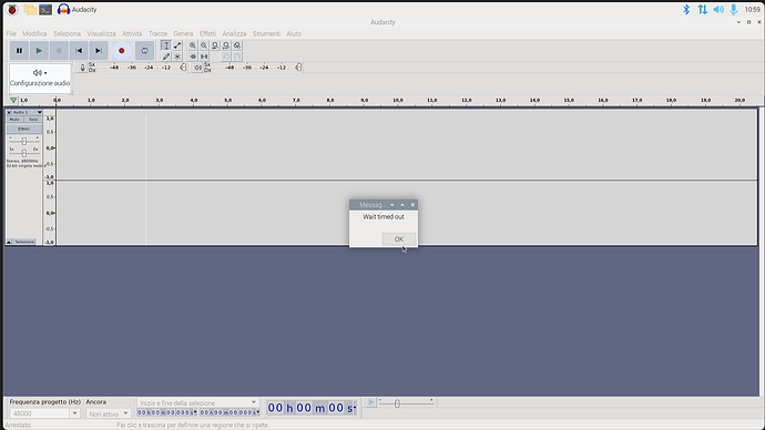

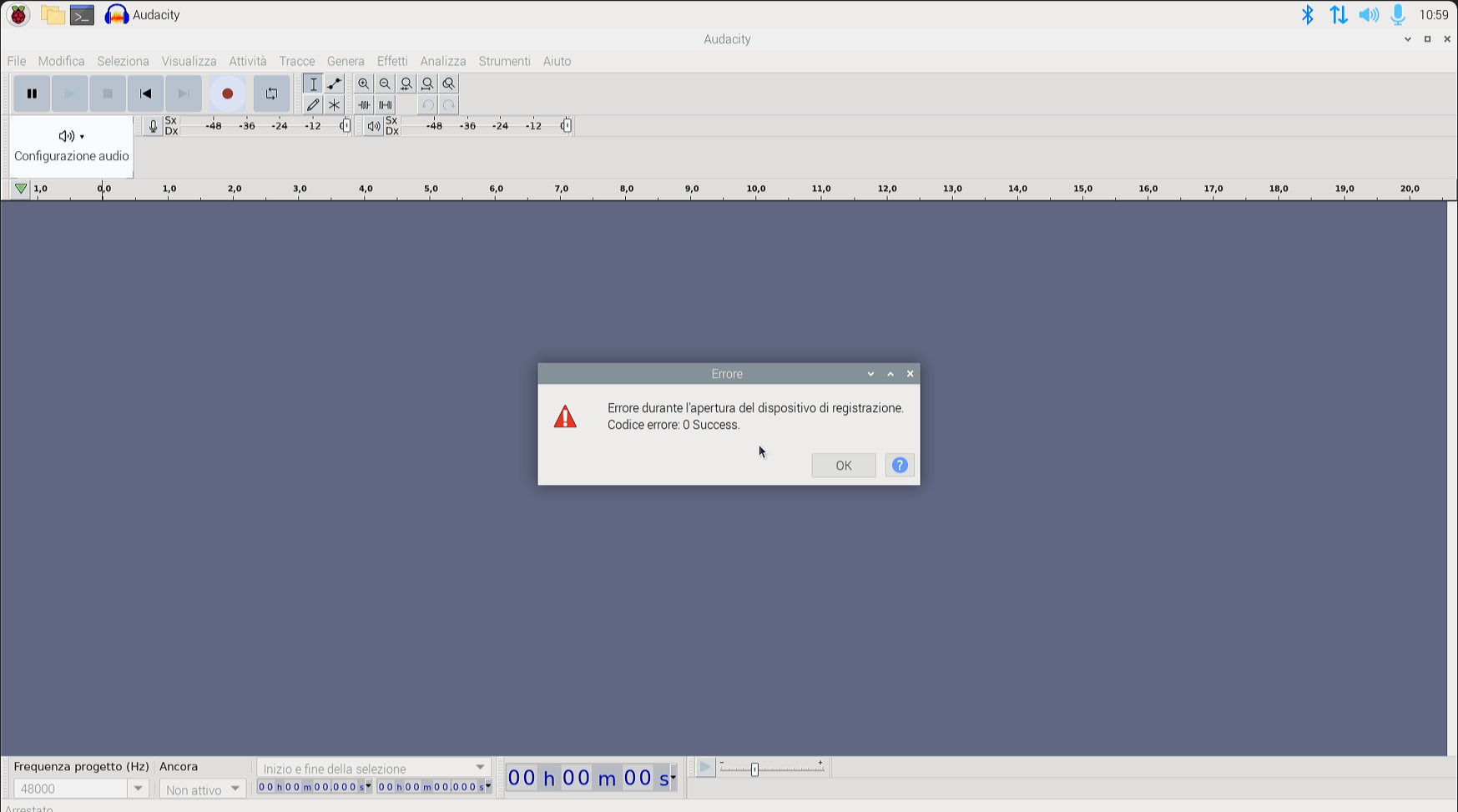

Hi, I’m having a problem with my Pi Audio Drive. First off, the system recognizes it as both an input and output device. Once I open Audacity and select the input and output devices—namely, “RPi Codec Zero: Raspberry Pi Codec Zero HiFi da7213-hifi-0 (hw:2,0)”—and start recording, the first thing I get is an error, as shown in the photo below.
First, it should be noted that all tests were conducted using both recording channels 1 and 2 and a sampling rate of 48,000 Hz.Inoltre dopo aver cliccato ok su questo errore compare questo : " Errore durante l’apertura del dispositivo di registrazione , codice errore : 0 success"

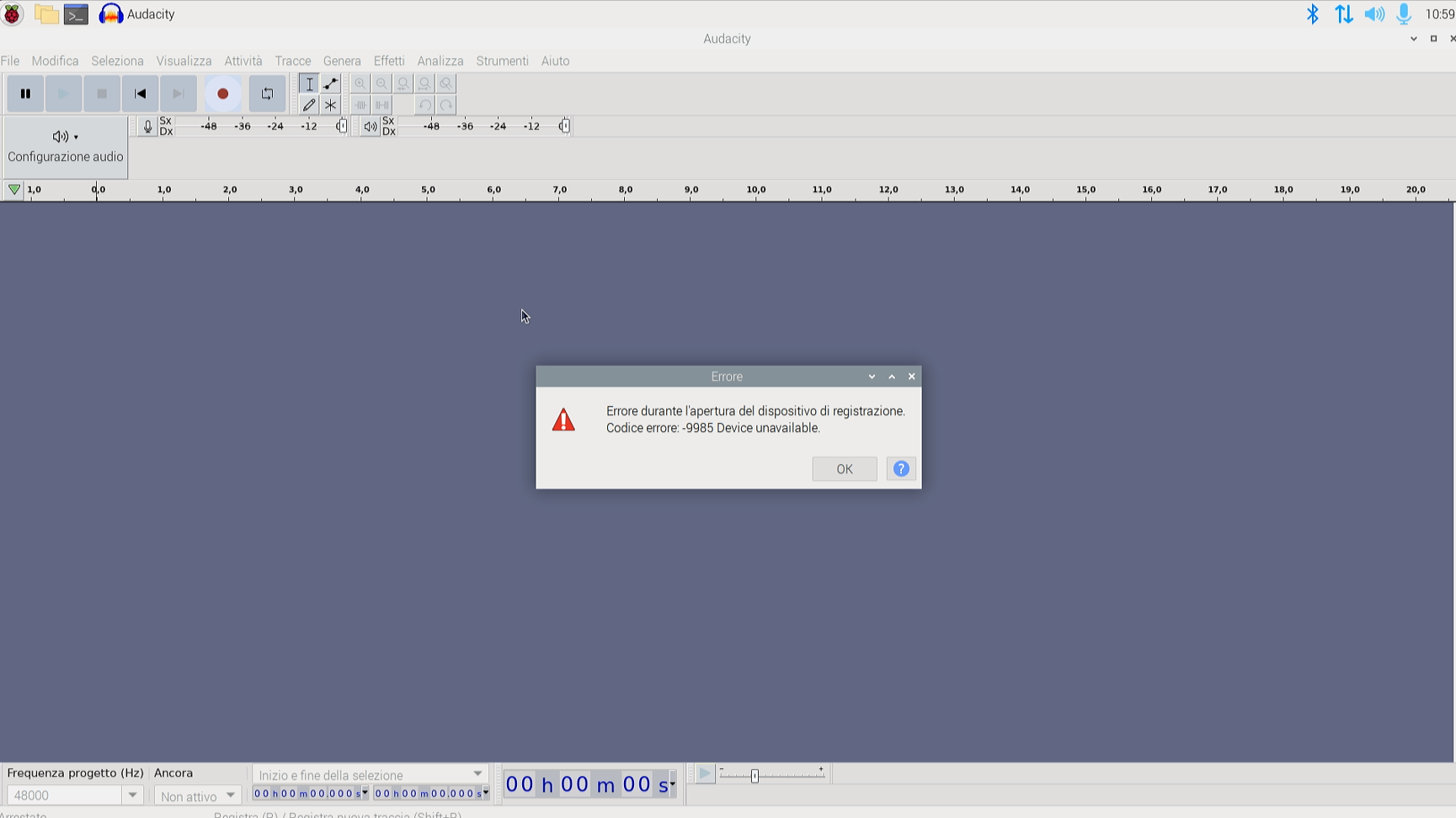

Once I click “OK” on this error, the next time I click on “Register,” the error code will be -9985 with the message “Device unavailable.”

The important point is this: hw:2,0 is the raw ALSA device. It is very strict. Audacity and Python audio libraries often try to open the device with slightly different parameters, or through PortAudio, and the raw hw device refuses that. After the first failure, the device may also stay busy, which explains the next -9985 Device unavailable error.

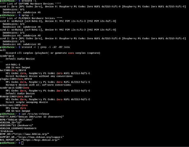

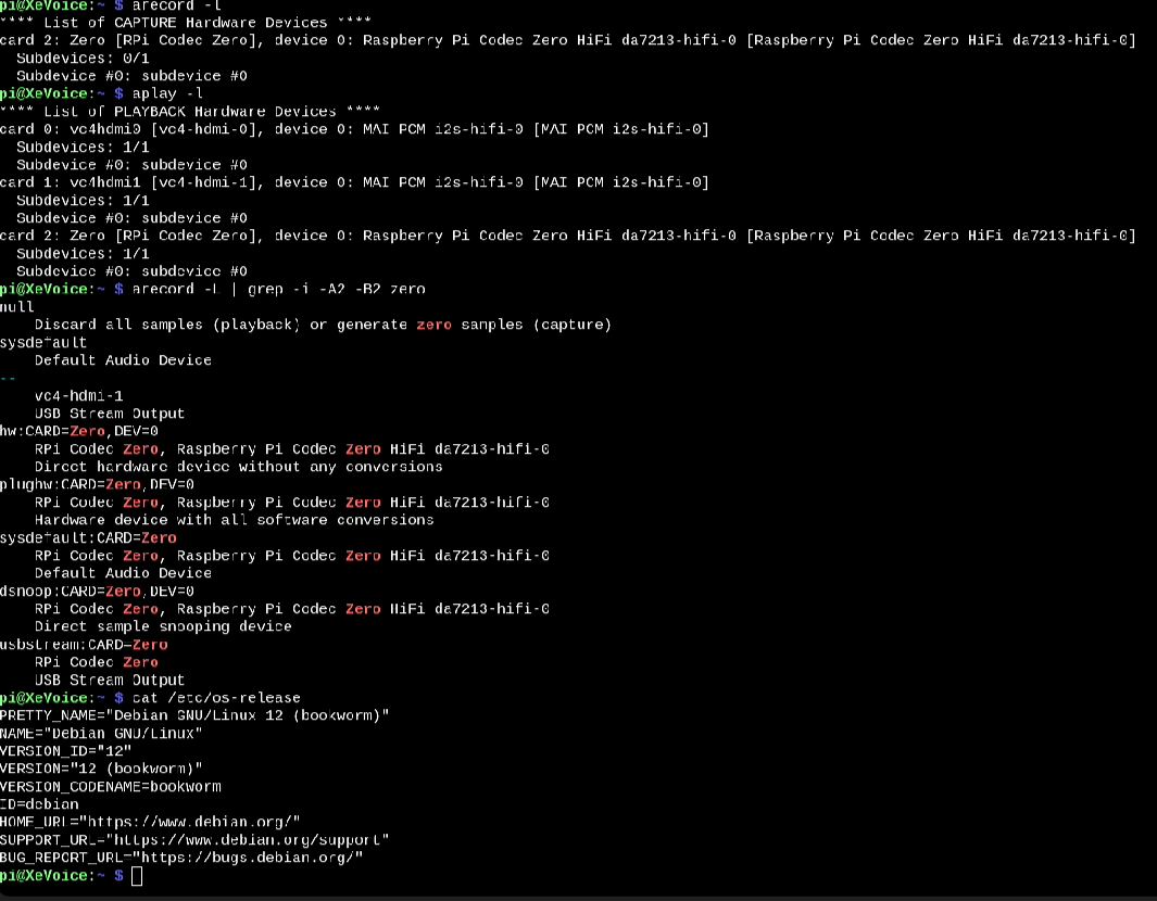

If you can, please post the output of:
arecord -l
aplay -l
arecord -L | grep -i -A2 -B2 zero
aplay -L | grep -i -A2 -B2 zero
cat /etc/os-release
That will tell us the exact ALSA device names on your system and whether we should use plughw:2,0, sysdefault:CARD=..., or another name.

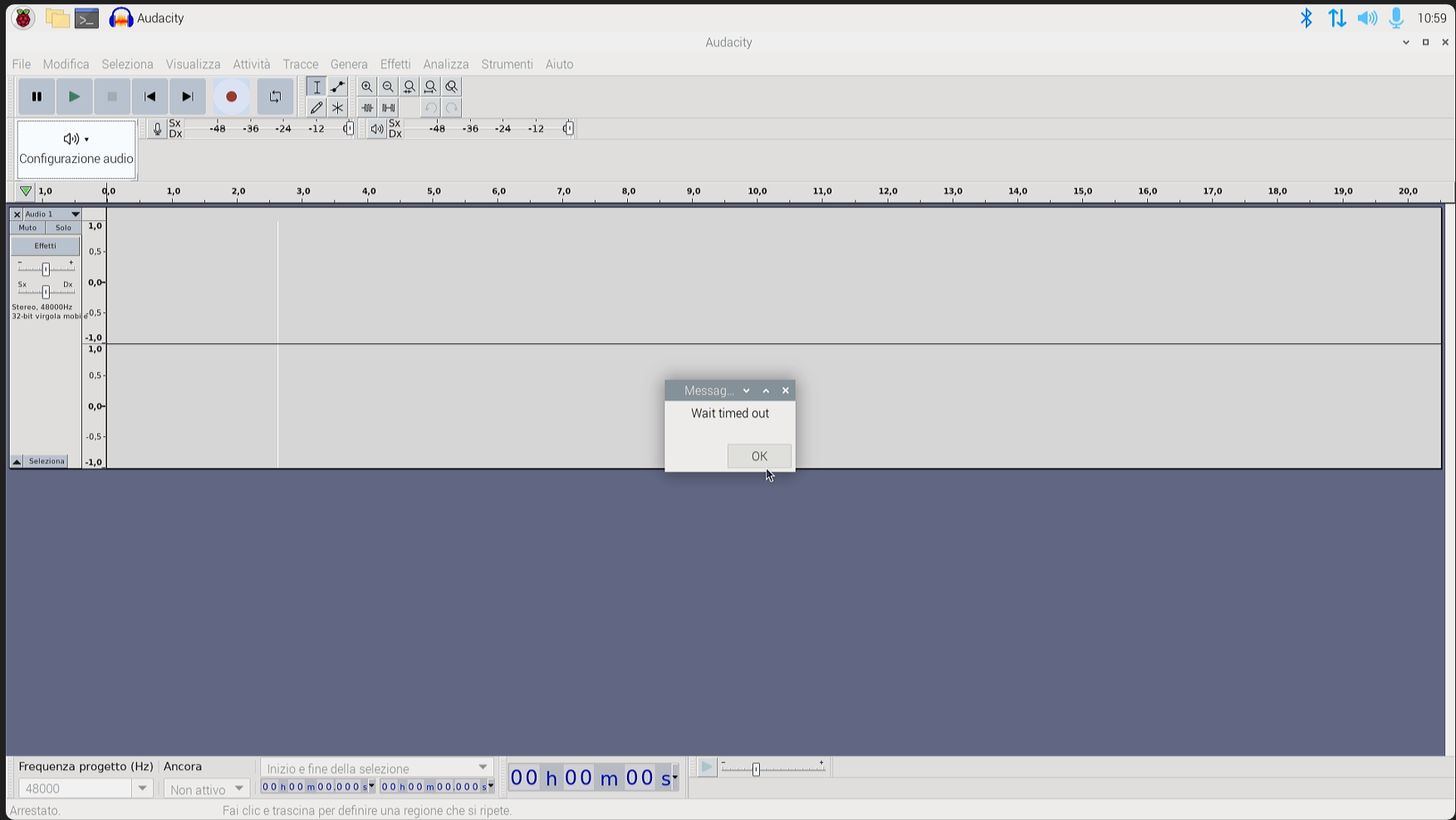

Thanks for the reply and the help, but sorry to say but they did not bring positive results, the command to record works, but as soon as I try the audacity settings they do not work, also making the asoundrc file and restarting does not solve anything, I attach below the screen of all the commands you asked me, thanks again
