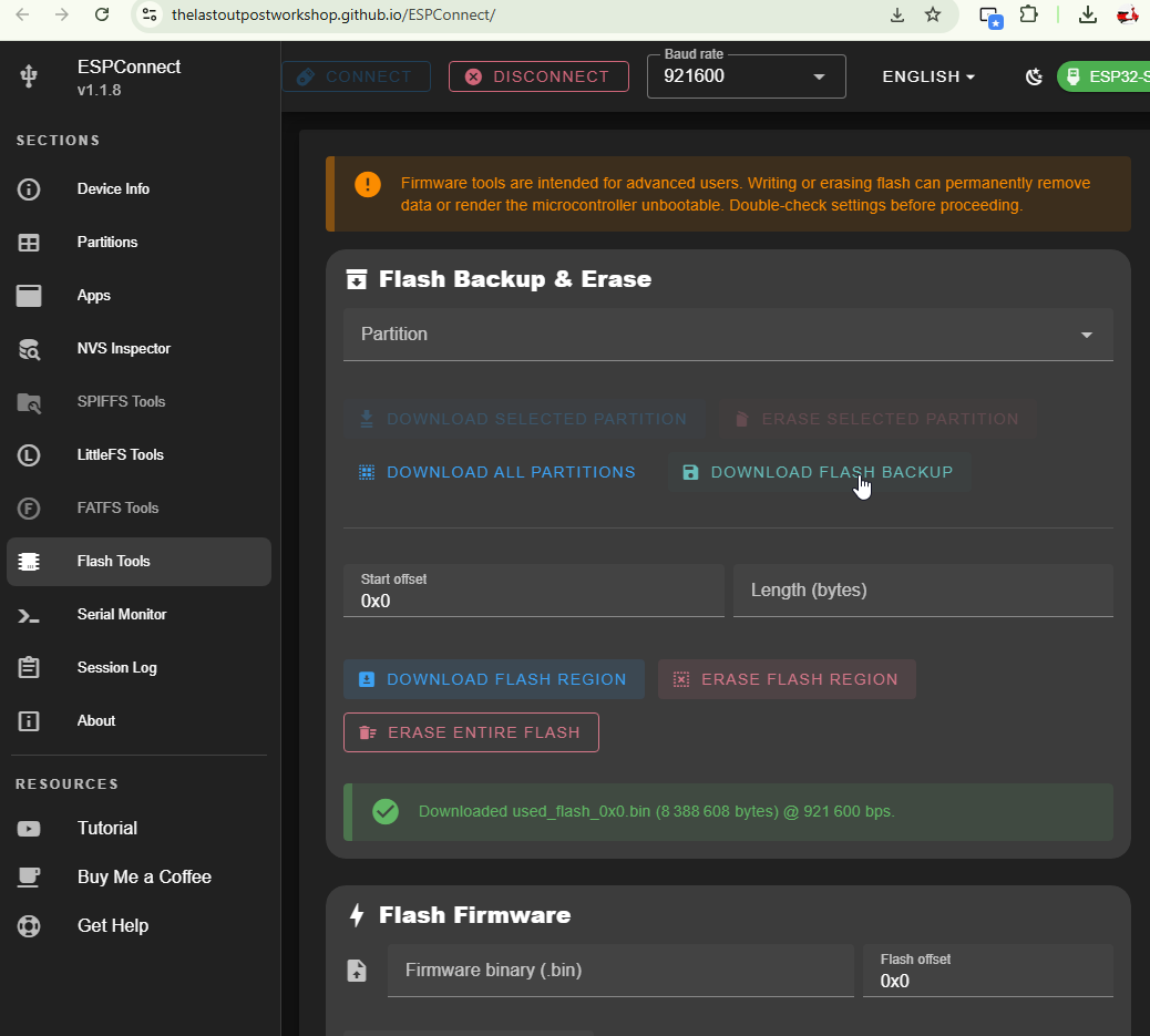

Hi
You can always save your full flash before doing any upgrade, this online tool is great for that :
https://thelastoutpostworkshop.github.io/ESPConnect/
in flash tool - download flash
