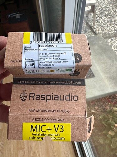

what is the model of card you are trying to install? We have 9 models
thx
MIC+V3 with not other shield/hat installed, just the the Raspiaudio.
I’m running on a fresh Raspbian GNU/Linux 11 (bullseye) installation.
