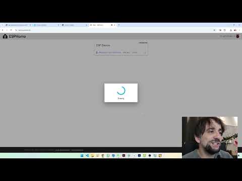

Ahhhhhhhhhhhhhhhhh, thats the trick.
Manuell compile, make a .bin and install the .bin via Com. I do it always ‘wirelessy’ … after copying the .yaml.
Ok, will try it within the next hour.
Thanks a lot.
