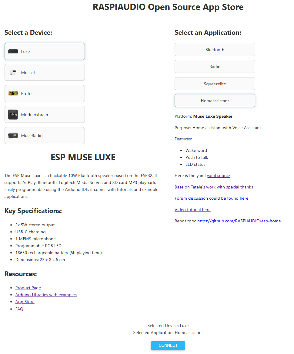

Sorry,
((the link has a typo)), but when I am on the page of the Musee Luxe, I can’t find a binary. And the link tu Git is also wrong.
So, where can I get the .bin file?

… you forgot the ‘r’ and I opened the link in Firefox (which doeesn’t support serial com) so standing is 1:1 now. (hihi).
Loaded the new .bin.
