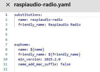

Can you please let me know if in this new version are available the WebRadio with the options to customize the radios over the link?
sbar
April 10, 2025, 4:27pm
79
yes ==> MuseRadioHomeAssistant.yaml lines 4 to 12
I think I will add some text esphome sensors in order to select from HA the streaming links associated to each 4 buttons
Can you please share some example?
At these lines i donāt see any entry for the links ā¦
Tks

Ok can you please let me know where I can find this file in my home assistant instance?
Thank you
