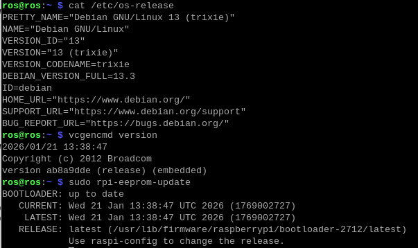

first did a full upgrade on Raspberry Pi 5:
sudo apt-get update
sudo apt-get upgrade
sudo rpi-update
then got :
cat /etc/os-release
vcgencmd version
from there:

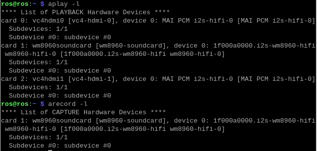

aplay -l
arecord -l
—> Ultra is on card1 for play and record
