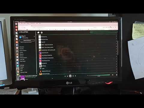

We found a workaround! Soon sharing how we did it
Here is the step by step procedure:
UPDATED LINK 21/04/22 :
let us know here if you have any troubles

Hey,
Good news.
I’ve installed the workaround and it is working… :smile:
Great thanks for the fix :+1:
